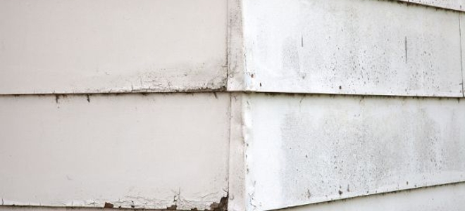

Siding
Damage to siding from winter weather can vary widely depending on the type of siding you have. Wood siding can lose lamination after being exposed to large amounts of snow, while vinyl siding can become brittle and crack in below freezing temperatures. When examining your siding, look for any cracked or damaged areas. Problem spots to concentrate on include under eaves and near gutter downspouts. Fill in cracks in vinyl with an epoxy and touch-up paint. With wood siding, use wood putty and paint to fix cracks or damages.

Paint
Now is a good time to see how the paint on the outside of your home is looking.
Now is a good time to see how the paint on the outside of your home is looking. Walk around your home and make a note of any paint that looks like it is ready to peel off or is already doing so. If the situation isn’t that bad, you can get away with simple repairs instead of repainting the entire house. Make sure you remove all the peeling paint, clean the area and sand it down before applying Peel Stop to prevent further peeling. After the primer has been allowed to dry, apply a final primer and then paint over it to match the existing color. Using this method will prevent further peeling and preserve the good paint.
