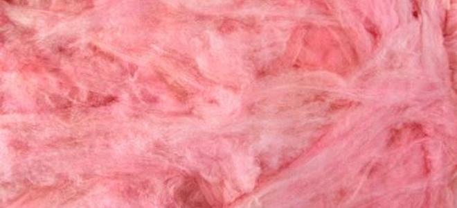

The most widely used insulation in the attic is fiberglass. Fiberglass commonly comes in 3 1/2 inch- to 6 1/2 inch-thick rolls. It can be applied in double layers to increase it past 6 inches. It is available in widths of 16 inches and 24 inches to fit between center framing members spaced at either interval. It comes in two forms: batt and blanket. Batt insulation is available in 4 foot or 8 foot lengths. Blanket insulation is available in lengths from 30 feet to 70 feet in standard manufacturer's thicknesses.
Types of Fiberglass Insulation
Fiberglass is available in foil-backed, paper-backed, and unfaced batts and blankets. Both the foil and paper act as vapor barriers. The foil, however, is only of value when used in conjunction with a 3/4-inch air space. Unfaced fiberglass is used in conditions of potential fire hazards and as the top layer of a two-layer application. Otherwise, paper-backed is used.
