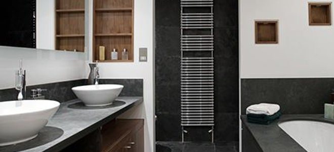

A luxury bathroom with his and hers sinks.
