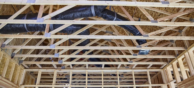

Flexible Ducts
Ductwork in a ceiling.
Flexible HVAC ducts are comprised of a wire coil surrounded by a thin but durable plastic that is enclosed in a layer of fiberglass for insulation.
Wire cutters or tin snips are used to cut the wire coil in a flexible duct. A utility or duct knife is appropriate for cutting through the thin plastic and fiberglass insulation that surrounds the flexible duct. Tensioning tools are used to install and tighten nylon ties for fastening flexible ducts to metal duct collars.
