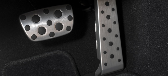

Brake Problems: How to Repair a Brake Pedal That is Too Low
a Brake Pedal

When your car has brake problems it is a very serious safety hazard. If you feel that you are having some brake problems you should take it very seriously. There are plenty of things that can go wrong with your brakes. You can have a sticking caliper, a leaky brake line, worn out rotors, or a "squishy", or "low" brake pedal. A low brake pedal is when you go to step on the brakes and it travels a long way before you start to feel the brakes engage. This can be caused by many different things. Here are some steps to fix this common brake problem.
