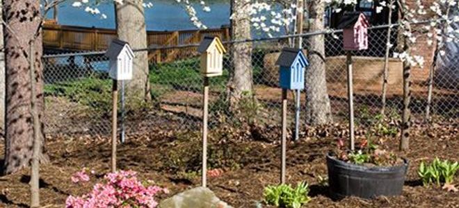

A garden can be spruced up by adding a great landscaping element such as a butterfly house. The following steps will show you how to build a "country cottage" style butterfly house in 5 steps.

Hanging
Choose an area where butterflies frequent, such as around your flower bed or a butterfly bush. If you have a tree branch that is low enough, you can hang the house from it.
Another option is to attach the butterfly house to a 6-foot long pole then put it in the ground.
