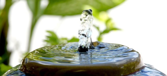

Build a Rock Fountain in Six Steps
water bubbling out of rock water fountain

A well-tended private garden can create plenty of serenity on its own, but a rock fountain addition can give the space some polish. Building your own is a relatively simple project that will give you free reign over the design for a more personalized touch. The following steps will show you how to make a bubbling rock fountain that is relatively small, inexpensive to construct, and simple to build.

Move the large rock you just drilled into position on top of the plastic tube protruding from the grate. The tube should only enter the rock about an inch. If more than that is inside the rock, trim it down.
Place about half of your small and medium stones on top, flat sides down and evenly dispersed in a single layer. Then, fill the container with water, plug in the pump and finish placing the rest of the rocks.
