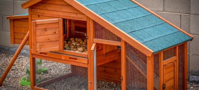

Raising chickens is becoming extremely popular as more and more people in urban and suburban environments are discovering the benefits these birds offer -- namely a great source of fresh, inexpensive eggs. Additionally, by raising your own chickens and producing your own eggs, you can vouch for their integrity in terms of the level of hormones and other chemicals that may be hiding in the food you don't produce yourself.
With that in mind, building a chicken coop is an important first step in raising chickens. While there are an endless variety of chicken coop designs to choose from, they all are built with several key elements in mind.

In its most basic definition, a chicken coop is a solid structure (i.e., four wa
In its most basic definition, a chicken coop is a solid structure (i.e., four walls and a roof) that provides a space for the chickens to safely sleep at night and roam around during the day. It has a door to allow the chicken's entry and exit and plenty of ventilation.
However, beyond that, the sky is the limit. Creativity and your level of finesse with woodworking and carpentry are the only true limiters here.
If you’re not feeling confident or inspired yet, pre-made plans and diagrams do exist online that are easy for a beginner to comprehend.
If you are new to woodworking or have never built a chicken coop before, don’t go crazy. Especially since this coop will be home for a living, breathing animal, the function has to somewhat trump form. As much as creative design choices make projects more fun, in this case, there is a high-risk factor if your ideas don’t pan out or compromise the utility of the coop.
