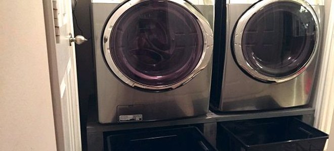

It only took major companies 30 years to realize that bending over while doing laundry is not fun, but now that these companies have decided offer washer and dryer pedestals, the cost is still preventing many consumers from taking advantage of this concept. When purchasing a washer and dryer for the first time, the cost alone can make you feel like you need to sit down for a minute and process, but when factoring in the appliance pedestals, which can cost upwards of $300 a piece, the grand total can be downright overwhelming.
Instead of saving up an additional $600 for these pedestals, build your own and save yourself a lot of money and major back aches.

Step 4 - Mount and Connect the Washer and Dryer
washer and dryer mounted on pedestal
Remove the drop cloth from underneath your pedestal and move the dry pedestal into your laundry room. Then mount the washer and dryer on top of it. (This is a two-person task.)
Slide under your pedestal and connect your washer and dryer hoses and wires to the manufacturer’s specifications.
Step 5- Baskets and Bins
washer and dryer pedestal with baskets
Add decorative bins or baskets under your pedestal for functional storage. These work great for hiding away dirty towels or tucking away dirty clothes that have held onto nasty odors or need stain treatment prior to the wash cycle. You could also use bins to tuck away laundry supplies such as a garment bag, detergent jugs, and more.
