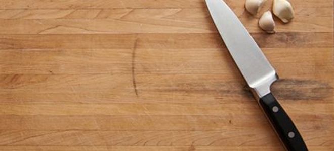

Step 3 - Finish the Cutting Board
cutting board clamped
After the board dries, take it out of the clamps and use a belt sander to smooth the top and bottom surfaces.
With a table saw or circular saw, cut the board to the length you want. If using a table saw, be sure that the cutting blade does not exceed 1/4" above the cutting board to prevent drag.
A shaper or a router can be used to round the sharp edges. Finalize your cutting board with a non-toxic finish such as mineral oil or a salad bowl finish for this project.
