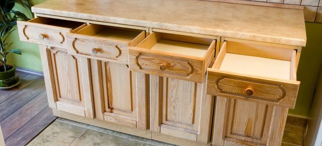

Building your own cabinet drawer will give you the ability to fit the exact size you need and give you the satisfaction of completing a somewhat challenging job yourself.
Step One – Careful Measurement
Measure the width, height and depth of the drawer opening. From the width measurement, subtract ½ an inch from each side (1 inch total) to allow room for drawer slides. Read the instructions that come with the drawer slides to see if they require a non-standard clearance.
Subtract ½-inch from the depth of the drawer to allow for clearance when it slides in and out.
The length of the drawer can be as long as the cabinet (the standard is 24 inches for most kitchen and bathroom cabinets), though you can make it shorter for easier use. 20-inch drawers are common.
