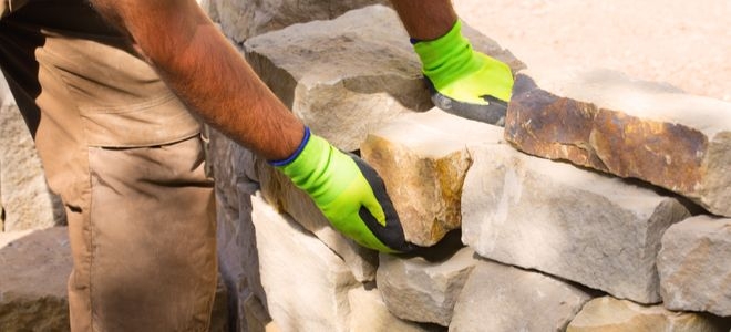

Step 4 - Lay the First Layer of Stones
Now it’s time to start laying your concrete blocks or bricks. Begin at the end that's either most visible within your landscaping or where the wall meets another structure. If your wall is along a slope, begin at the lowest point.
Place the first stone in the trench, taking care to ensure that it’s level on all sides. If you find that the stone is not level, remove it and add more gravel or dig the trench deeper as necessary.
To keep your stones level across the entirety of the wall as you lay the stones, hammer wooden stakes in the ground at each end of the wall layout line and the trench. Then, tie a string to each stake so that it is even across the top of the first stone that you laid. Level the string. This will serve as a guide to help you evenly lay the rest of this layer of stones.
After that’s done, continue laying the stones next to each other along the length of the trench. The first layer is key to a strong and successful wall, so check that each stone is level and laid correctly as you go.
hands laying stone into cement to build a wall
