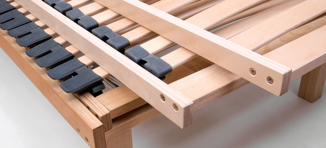

Building a queen size slat bed is a great project for someone who wants to learn basic woodworking skills, or needs an extra bed in their home. This type of bed is perfect for a spare bedroom, a camp, or just having a new bed without having to buy one. With some very basic woodworking tools, and beginner knowledge, a do it yourselfer can easily build a queen slat bed in a day.

Stand one of the front posts in a vertical position and slide one of the side stringers into the notch. Stand one of the footer posts up and slide the end of the stringer into the notch. Do the same with the other side. Slide a five-foot two by eight into the corner notch of the head and footer posts. Then complete the assembly of the frame by sliding the other posts into the five-foot lumber. Use two-inch carriage bolts at each intersection to secure the bed frame together.
Step 5 - Insert Slats
The slats are easily slid into the notch you routed out into the bottom of each side stringer. Lay them out and slide them into the notch for a semi loose fit. They should be able to move a little and have some space in between them. Place your mattress on them and you're ready for a restful sleep.
