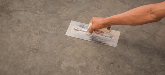

Someone hand troweling a concrete surface.
