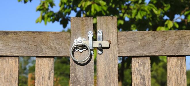

Step 4 - Hang Gate
Finally, you are now ready to hang your gate to the posts. Start by attaching the hinges to your gate frame. Hold the gate up in the opening next to the post where the gate will hang. Attach the hinges to the post. Decide where you want the latch for your gate. You can attach it either on the top or the side of the gate.
There are several types of latches available at your local hardware or lumber store. Once you have the hinges and latch installed, close the gate and mark the inside edge on the post adjacent to the latch. Cut a strip of wood the length of the gate and nail it to the post for the gate stop.
