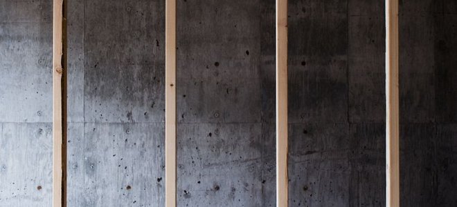

A series of four wall studs with a cement wall in the background.
Now that you have an idea about the materials you’ll need as well as any mistakes you’ll need to be wary of making, it’s time to get to work on the wall layout.
Studs (wall framing members) are placed on either 16-inch or 24-inch centers. This means from the exact center of one stud to the exact center of the adjacent stud is 16 or 24 inches. Check with your local building code to see which distance is required for your area. It will often depend on any snow or roof load.
