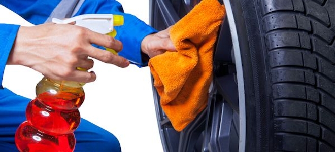

Step 1 — Clean Your Car and Wheels
Take your car out of the garage and either bring it to a car wash or wash it yourself. If you are washing your car yourself, make sure your car is completely cleaned from top to bottom and dried thoroughly. Try using a self-serve car wash to get the best results.
As you wash and dry, pay special attention to the wheels and rims of your car. Take out a soft cloth and wipe the car rims fully dry. Dispose of the cloth.
Step 2 — Apply a Solvent
In order to fully remove the dirt from the interior of the scratch, use a light solvent. Take a soft cloth or a car rag and apply a little solvent to the tire rim scratch. Work the solvent into the scratch well. Rinse with water. Dry completely with another clean cloth.
