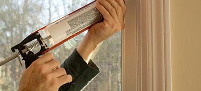

Caulking a window
Caulk is used to keep water and moisture where it belongs, preventing it from seeping into cracks and seams. A bead of calk around a tub prevents steam from invading the walls, and caulk around a window keeps the rain and weather out of your house.
Laying a bead of caulk is easy, but doing it without making a mess can be a challenge, and doing it so it seals properly and smoothly is essential. These insider tricks can help you get the job done right.
1. Use Masking Tape for a Neat and Even Application
Here is a trick to keeping that caulking bead looking straight and clean. Use masking tape around the seam you are caulking, keeping the two pieces of tape at a distance the size of the desired bead. Lay down your bead of caulk. Use your finger to tool the caulk by pushing the excess onto the tape. After tooling, remove the masking tape, and you'll find a nice-looking, straight, clean, smooth bead of tooled caulk.
