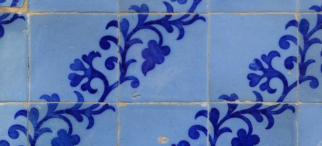

blue tiles with dirty grout between them
