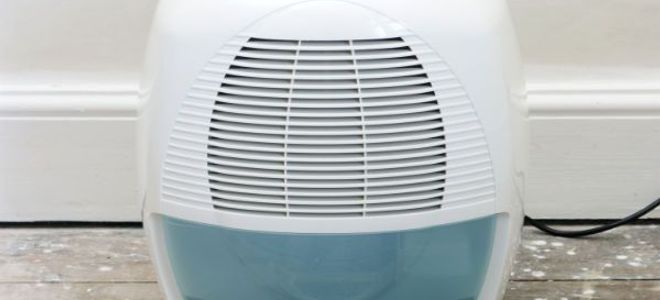

A crawlspace dehumidifier is the homeowner’s weapon against mold and mildew. It is important to buy a crawlspace dehumidifier with the correct capacity; otherwise, it will not remove enough moisture to combat the mold. The following article details the primary capabilities of a crawl space dehumidifier and provides guidelines for choosing the right one for your space.

Air flow is the cubic feet of air that needs to move per minute to keep your space dehumidified. The right crawl space dehumidifier will have enough power to create the proper cubic feet per minute of air flow (CFM) for your space and remove the moisture without running constantly.
To determine the required CFM for your crawlspace, multiply the cubic feet of the space by the air changes and divide that by 60. As an example, a space with 3,000 cubic feet needing 3 air changes per hour requires 150 cubic feet per minute air flow.
