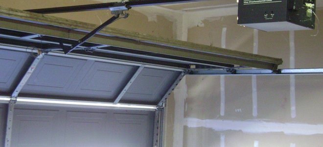

Garage door openers don't all work the same way
  • Most garage door openers use one of three different mechanisms - chain drive, screw drive or belt drive.
  • Chain drives are the most common and the least expensive, in the range of $150. These openers use a metal chain about the same size as a bicycle chain to open and close your garage doors. Their popularity is primarily due to their cost since the chain drive mechanism is louder than the other technologies and since the chain can stretch, usually require the most maintenance.
  • Screw drives run along a threaded steel rod to operate the door. The screw function results in quieter operation than the more popular chain drive but also increases the cost.
  • Screw driven openers generally range in price between $175 to $250
  • Belt drive openers uses a flexible rubber belt mechanism to raise or lower the door. The belt is made from a compound similar to steel belted radial tires so it's very strong , quiet in operation and requires virtually no maintenance. You'll usually pay more for a belt driven system with prices starting around $200 and going up from there.
