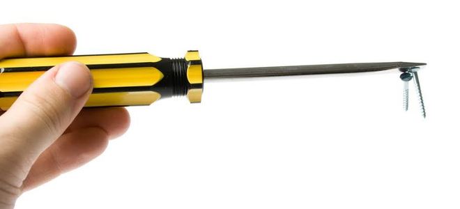

Forget Dropped Screws
Magnetize your screwdriver to get rid of the issue of dropped screws that have you scrambling on the ground! Rub a magnet along the shaft of your screwdriver roughly a dozen times in the same direction. After a few seconds, your screwdriver will be magnetic and will keep the small items from falling.
