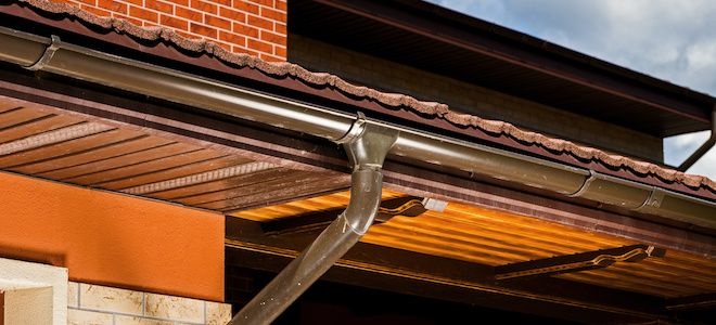

copper roofing underside
Copper roofing can be a beautiful touch to a building, whether the roof is clean and bright or possesses the characteristic green hue unique among roofing systems. However, copper roofs can also quickly become black and mucky looking. You can spiff up your dirty copper roofing by cleaning it with either of the following homemade techniques, avoiding the use of expensive commercial cleaners.
