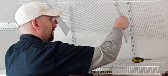

A man remodeling a space by adding shelving.

Maybe you have already decided what kind of material you want to use for your shelving system, but if you haven't, you need to do so while you are designing your space. There are two basic ways to build an organizational structure in a closet. The first is to use a system of pre-fabricated hangers and brackets that hold lightweight wire shelving coated with rubber. There are several manufacturers of wire rack shelving, but they are all similar in design and functionality. This wire shelving is available in a variety of sizes and depths and can be arranged to incorporate rods for hanging clothes if needed. There are also a number of accessories available that are designed for hard items like shoes, which can be difficult to keep organized.
