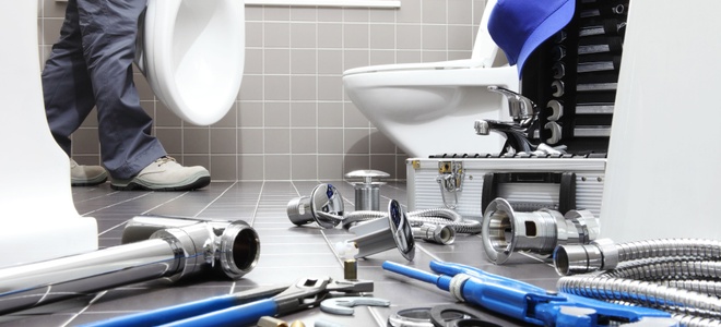

For most, home ownership means becoming well-versed in all sorts of minor DIY repairs. Some of the most common problems homeowners face are plumbing related. Plumbing contractors charge a premium no matter how big or small the job is. Learning how to tackle small plumbing issues around the home yourself not only helps to restore service and preserve your property, but also your savings account.
