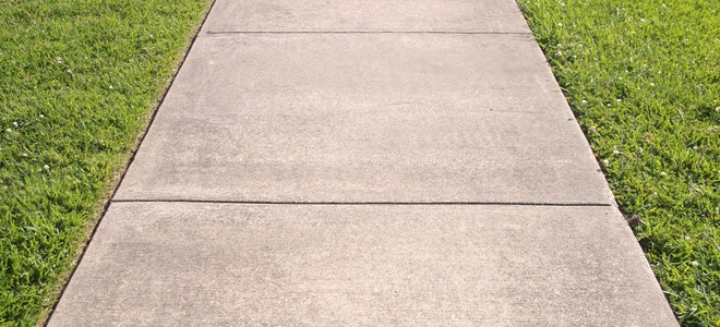

Concrete is an extremely strong, durable material made from cement and aggregate. Concrete is porous, whether used as a floor in garages, porches or patios, driveways, or walkways. Often porch or patio floors will have an extra smooth surface, but it will still absorb stains easily.
