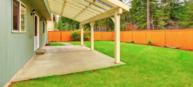

Your concrete patio is usually a place where you, your family and friends can hang out and have fun. But over time, your patio can become less than nice due to weather, use and animals. One solution, other than redoing your patio, is to acid-stain it or paint it. Regardless of which method you choose, preparation is a key factor when you resurface your patio. This article will show you how to prepare your concrete patio for resurfacing.
Step 1 - Clear the Concrete Patio
Before you can stain, paint or acid-wash the surface of your concrete patio, you must clear it of any debris that may otherwise ruin a good resurfacing job. First, remove any furniture on your concrete patio. Place the furniture in an area where it will be safe from splatters and mistakes.
Next, use the large broom to sweep away leaves, gravel, rocks and fine dirt. If you wash the concrete before this step, you run the risk of creating stuck-on mud that you may not notice until later.
