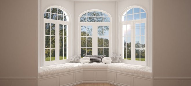

It's easy to construct a window seat out of premade upper wall cabinets. The great thing about this method is the framing has already been done for you. Follow these tips to constuct a window seat out of pre-made wall cabinets.

  • You can finish off your window seat by adding decorative moulding to the edges of the plywood and painting or staining to match, or by stapling fabric over the plywood.
  • Some people pad the plywood itself to make a cushion, but your seat will be more comfortable and versatile with separate cushions.
