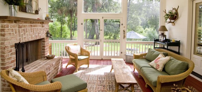

A screened-in porch.
Your porch is an extension of your home. In some areas, having your porch screened in offers a much-needed reprieve from the natural elements in your area. If you’re thinking of transforming your porch into a screened-in porch, here are some things to keep in mind.
