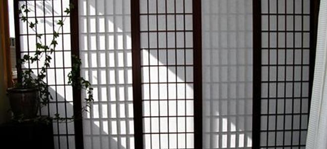

The Shoji screen remains one of the most popular items in Japanese style décor. Originating during the third century, the screens have folding panels made of wood with translucent rice paper insets. Its original function was to act as a room divider while providing illumination. They gained great popularity when American architect Frank Lloyd Wright discovered them on a trip to Japan, brought them back, and started using them in his house plans. They became more popular when architect Walter Gropius began using the Shoji screen as an integral part of his living space design. At first, he employed native Japanese artists but soon these beautiful works of art were imitated by American crafts professionals.
Now, with a little patience and a little guidance, home décor enthusiasts can create their own Shoji screens.

Your completed Shoji screen can be painted and decorated in whatever fashion you like. These beautiful Japanese folding screens can change the ambiance of any room creating a peasant and even calming mood. The screens can be placed at open, window areas to dim the lighting or can be used to divide room areas, separating one portion from the other or “screening” an area from viewing eyes.
