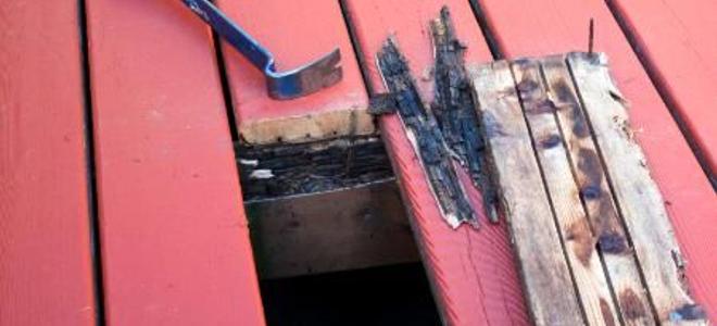

Begin by removing every floorboard that touches the affected joist. This may be just a few, or it could be the entire floor. It depends on the size and pattern of your deck. Ideally, the floor was screwed down and you can remove these boards with a cordless driver. If, however, the floor was installed with nails, you must use a hammer and a pry-bar to remove the floorboards. If you plan to re-use the boards, take care not to split them when pulling them up.
Once you have access to the joists, remove the nails that secure the broken joist into its hanger. The joist should just slide right out. Carefully measure the correct length for the new one and slide it into place. If it looks like the hanger is damaged or excessively rusty, then go ahead and replace it as well. After you have secured the joist into the existing or new joist hanger, re-place the floorboards back in their original pattern. If you have to remove a large portion of the floor to access the joist, you may find it helpful to label the floorboards so you have an easier time figuring out where each one goes when the time comes to put them back on.
3. Broken Floor Boards
Broken or splintering floorboards are probably the most common type of deck maintenance required. Since the floor is consistently exposed to the elements, the surface is most likely to suffer the effects of harsh wind, rain, snow, ice and the pounding sun.
Replacing the floorboards is relatively easy. It is just a matter of removing the ones you want to replace and installing the new ones. You can even use the old boards as a template when you are cutting the new ones to the correct size. This assures an accurate fit and helps to maintain the original quality and professional appearance of your deck.
