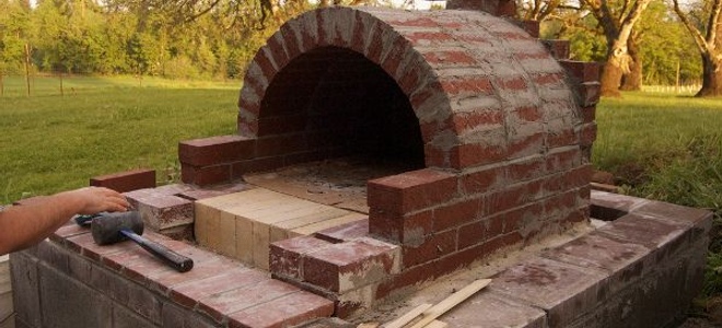

Arrange your bricks or stones before you mortar them into place to get a sense of how you will build your oven. Stack the bricks in a square shape on three sides around the pallet. The front of the square will be made into an arch.
The top of the oven is an extension of the arch that will create a rough dome shape that slopes down to the side walls.

Use cardboard or foam as needed to support the structure before you apply the mortar. Stack the oven walls and center dome to the desired height and mortar them into their permanent positions using a trowel. If you’re adding a chimney, place the bricks around it to secure it into place.

Step 15 - Place the Oven on the Base
Place the oven on top of your base, at the center of the "L." It will be heavy, so don’t be a hero. Get help putting the oven into position on the base, and make sure it’s square and centered so it will stay up there.
