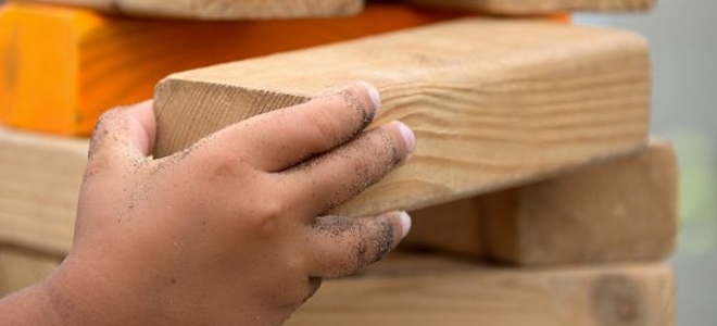

Step 1 - Measure and Cut Your Boards
When choosing your 2x4’s, get the straightest boards available. If they are warped or twisted, they won’t stack squarely. If there is cupping (when the inside of the board is concave), the boards will wobble and tilt, which is not very conducive to this game. It may be worth it to pay a little extra and get the best boards in the lumber yard.
Each Jenga piece is going to be 10 ½ inches long. Each board should yield nine Jenga pieces (with a little piece of board left over). When you're done with all your cuts, you'll have 54 blocks that will make up your new backyard game. When you're measuring, be sure to allow for the width of the blade you're using. Although it's slightly more time-consuming, I prefer to measure each cut after the previous cut. If you measure out 10 1/2 inches all the way down your board and don’t allow for the width of your blade, you will have uneven pieces.
If you're using a chop saw, you can be done with the cutting in no time at all. A circular saw is the next best thing if you don’t have a chop saw. Just be careful that you are at a 90-degree angle and not off on some wild tangent. And a hand saw…well, you know you'll be aching tomorrow—that’s a lot of sawing!
Step 2 - Sand the Wood
Sand each piece until it's smooth. The pieces must be able to slide easily when stacked together. The sawn ends will need extra special attention. Any burrs or rough edges will hamper your game. If you want to make your game more colorful, you could stain each piece. Make sure they are completely dry before stacking them. Whatever you decide, do not paint or varnish the game pieces. When outdoors, humid air may cause painted or varnished pieces to stick to each other. You will want your game pieces to slide effortlessly.
