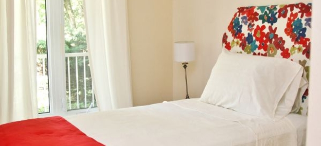

A floral upholstered headboard in a bedroom.

Create your own headboard with materials available at your local hardware store and fabric shop. An upholstered headboard can customize a bedroom's décor and match just about anything, from furniture to blankets and curtains, and can be hung behind your bed for a unique, one-of-a-kind accent in your bedroom.

Your new DIY upholstered headboard will perfectly tie your room together. And, the best part is that it didn't break the bank!
