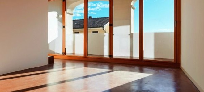

One of the great things about industrial design is that it’s probably already built into your house. Making these rugged materials the focal point of your space is just a matter of highlighting their unique qualities. In the case of concrete floors, taking them from being a common building material to the star of the room can be as simple as staining them.
These projects can be done in basements, garages, patios, or anywhere there is a solid slab of concrete on the ground. If your floors are in good shape, free from cracks or gouges, you can easily put down a stain with just a little prep work.
