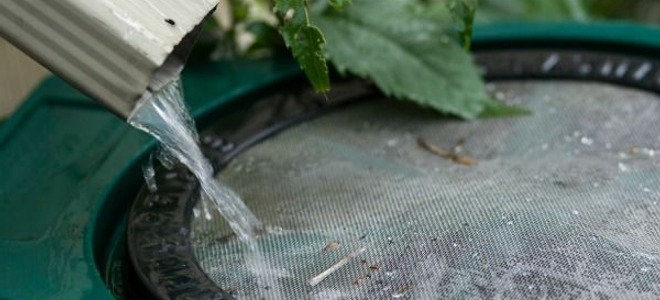

PVC Water Storage Tanks
If you are ready to shell out $1 a gallon for rain water storage, these tanks come in capacities ranging from 300 gallons to 10,000 gallons. They are specially designed, with a food-grade interior and often a UV-stabilized black or dark green exterior that prevents algal growth in the tank by blocking sunlight. Another advantage is that in addition to a top lid, they come with precision-cut openings at the top and bottom that can serve as water inlet and overflow outlet.
DIY Water Collection Ideas and Tips, PVC tank
You can direct the gutter downspout to the tank and fix it with a suitable coupling fitting the top inlet. A long flexible pipe attached to the bottom hole can be used to draw water whenever required, and then kept raised when not in use. It will act as an overflow pipe when the tank is filled to the brim. Your water storage capacity can be gradually increased by connecting several tanks in series.
The water stored in these tanks can be directly used not only for gardening, but for bathroom, laundry, and cleaning needs in the house. A home water purification system can render it potable too.
