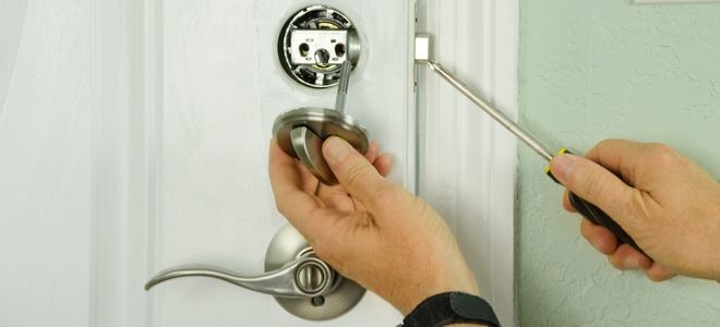

Installing a Deadbolt
hands installing disassembled deadbolt lock
  • 1-3 hours

Installing a deadbolt is one of the easiest and most effective ways to protect your home. In most burglaries, thieves enter the home through a door. The common key-in-knob lock can often be opened in a matter of seconds by a criminal with a credit card or a screwdriver. Deadbolts are significantly harder to get through, and several factors can further increase that baseline of security.

Installing a deadbolt is a rather simple project and should take no more than two to three hours and require only a few special tools. The main thing is to be sure of the exact location of the holes before you start to drill. If the hole is improperly drilled, it can ruin the door. Also, be sure to use long, three inch screws for the strike plate to penetrate deeply into the frame behind the jamb.

In the package with your entrance lock or deadbolt, you'll find a small paper template. This template is made to show you exactly where to locate the two holes you need to drill to install the lock. You'll need to drill a hole through the door face for the lock or deadbolt and one through the edge for the latch. These two holes must be coordinated so the mechanism will properly fit together. The template is your guide to doing this correctly.
First, figure out how high up on the door you want to install the lock. For entrance locks, it is usually 36" above the floor. The main thing to watch for is the location of the old strike plate. If you will not reuse this strike plate be sure you do not install the new strike plate directly on top of the old. The chewed-up area of the frame at this point won't provide a good surface for the new strike plate screws to bite into.
Instructions on the use of the template are usually provided in the package. Most of the time you simply bend the template and wrap it around the door so that one specified side is on the face of the door and the other side is on the edge. Two holes are provided in the template, to make your marks on both the edge and the face. With a sharp instrument or nail, make marks in the doors at these two points.
Check your work to be sure everything is as it should be—you don't want to scrap a good door because a hole was drilled off.
