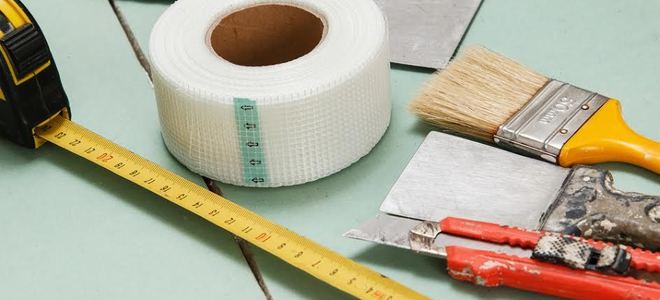

Drywall panels
Measuring tape
Straight edge
Drywall knife
Utility knife
Hammer
Nails
Drill
Drywall screws
Drywall tape
Joint compound
Joint compound tray
Joint knife
Drywall corner bead or paper tape
Sandpaper
Dust mask
Safety goggles
Work gloves

2. Use your measuring tape, straight edge, and drywall knife to measure and cut your drywall to size. To make drywall cutting easier, score the front of the drywall panel and carefully snap in half. Cut the paper backing with a utility knife.

2. Cover all seams with a mesh drywall tape. Use your joint compound taping knife to press the tape against the seams.
