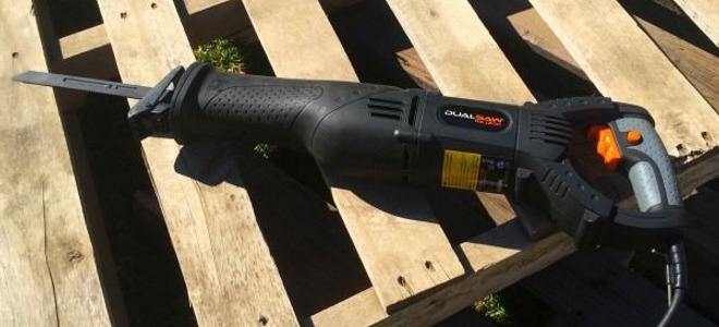

With all that as given, I was a little skeptical when DualTools introduced their answer to the reciprocating saw, the DualSaw RS1200. On the other hand, there are good things to be said about their signature product, the DualSaw CS450, so I cut with an open mind.
The Features
The saw has two blades next to each other that cut on opposite strokes. The idea is to reduce vibration and kickback and increase stability and control. It also has a 180-degree rotating handle that locks in the vertical or in either horizontal orientation. This way you can hold the handle straight, but cut sideways – again to increase control and comfort.
The Function
The saw is as powerful as my old one, but it is longer and heavier. It’s also balanced with most of the weight toward the blade end. I presume this was done on purpose to let gravity help you make vertical cuts. If that’s the particular cut you’re making, it works, but I found it awkward to wield and even walk around with.
Maybe because I already know how to use a reciprocating saw I didn’t find the rotating handle useful. In all these years, I’ve never wished the handle rotated on my old one. I quickly abandoned this feature. Maybe someone who’s never used this type of tool before would find it a helpful shortcut, but I don’t think so. Also, that rotating handle is exactly where this thing is going to break.
The quality of the actual cutting depended on the situation. It broke down a wood pallet as well as my old saw, but not better. The balance was an issue. Maybe the double blades cut faster, but the greater size and weight and the awkward center of gravity made it slower to use overall.
