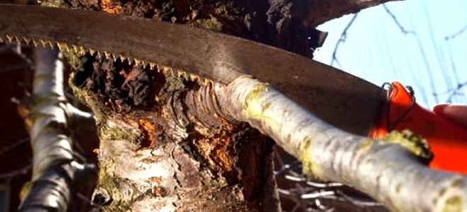

Making the Cut
trimming the end of a tree branch
Select a spot about three inches from the collar of the branch (the thickened, collar-like place where the parent and child limb intersect) and make a cut about 1/3 of the way through the branch. This will prevent the branch, when severed, from tearing through the collar or the parent branch and harming future growth. Make this first cut on the underside of the limb.
Cut slightly beyond this first slice and cut straight through the branch to be removed.
Make a final cut through the remaining portion of the branch, as near to the collar as possible, without touching the collar itself.
