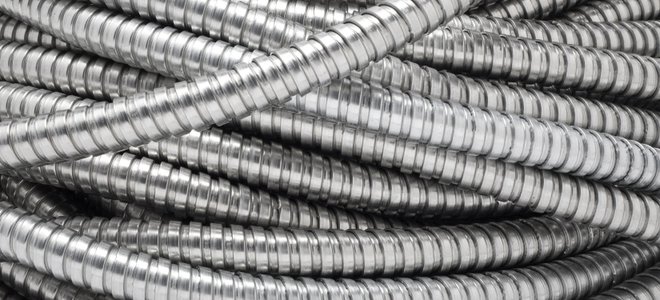

spiral of silver colored Electrical Conduits
An electrical conduit is an excellent way to protect and route electrical wiring that runs throughout a building or your home. A conduit can be made of various types of materials, such as fiber, metal or plastic, and it may be flexible or rigid in its design. Conduits are pipe or tube-like in appearance and are used to shield electrical wires from impact, water and vapors. Conduit comes in many sizes that vary in diameter based on the application and use of the conduit.
