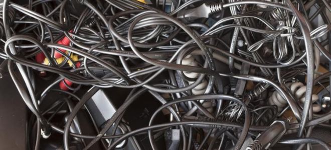

Electrical control panel wiring should be organized well or it can be unsafe or hazardous. It is important that wiring be held together neatly using wire ties to ensure that everything is in an organized and neat order. It is advisable for everything to be tightly connected and there should be a logical order for the wire connections.
For easy troubleshooting, a control panel wiring diagram should be available near the control panel if in case a technician needs to troubleshoot the wires and controls. If these simple rules are not followed, the control panel wiring may be left in disarray and technicians might have a hard time troubleshooting the control panel in the future.
