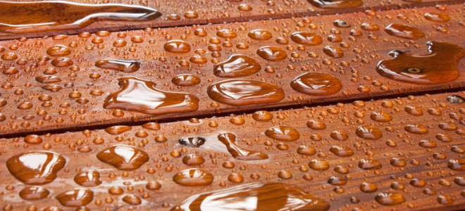

Applying exterior wood stain to an entry door, porch deck, or railing is the decorative aspect of the finish. This must be followed by a protective sealant, such as spar urethane, to ensure that the wood is not damaged by the weather. There are very specific steps for staining and sealing exterior wood. If the wood is not a new installation, chances are it already has some type of finish on it. Painted wood must first be stripped of its coating in order to proceed. This how-to will guide you through the process of decorating and protecting outdoor wood.

Stain the Wood
With your chosen stain, open up the can and have a clean rag at the ready. Wear new latex gloves for this as well. Dip in a foam brush and begin to apply the stain in one area of the wood with the grain. Work the stain into the wood with the clean rag, always rubbing with the grain. Don't try to cover the entire piece at once. Go in small sections. Some stains may call for more than one coat, but not always. Read the manufacturer's directions.
Finish the Wood
After the stain is in, it's time to apply the sealant. Spar urethane is an ideal product for this because it protects wood so well. You will apply it in much the same way as the stain, although you will not rub it in with a clean rag. Apply a coat evenly over the entire surface. Let it dry until it's tacky. Go over it lightly with the sandpaper, smoothing it out a bit before applying the second coat. Let that coat get tacky as well, before coating it a third time.
All of your exterior wood pieces can be stained and sealed in the same way. Once sealed, they're protected from the elements as well as decorated in a way you're happy with.
