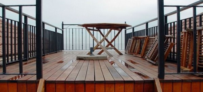

Start at a surface level by checking the integrity of your deck’s finish to determine if the existing deck finish is still intact or needs to be restored. One simple way to find out: pour a cup of water onto the deck surface; if the water doesn’t bead up, it’s time to restore the finish.
Clean It
The first step in refinishing your deck is a thorough cleaning. The CRA recommends a solution of 1 cup TSP and 1 cup of household liquid bleach in a gallon of water. Other cleaners such as Simple Green and oxygen bleaches can also be successfully used. Scrub the solution with a long handled bristle brush and let it sit for 15 minutes or so before thoroughly rinsing with a garden hose. While powerwashing can be a valuable tool in the hands of a professional, homeowners should use with caution to avoid damaging the deck.
Inspect It
With the deck surface clean, take a walk around the surface and perform a visual inspection – look for loose nails that may have worked up from the surface over the past year, add oversize deck screws where needed, see if any boards could use sanding or replacement. Also spend a few minutes to inspect under the deck, looking for any decayed joists, ledgers or posts. Some woods, like redwood, have an abundance of natural strength and beauty that last for decades without warping or cracking. Taking time to inspect and address any potential issues early makes your deck last even longer.
Brighten It
A wood brightener should be applied to your deck surface next. An oxalic-based brightener will restore the color to the wood and will remove most common wood stains including tannin and rust stains. Be sure to follow manufacturer’s application instructions. Rinse the surface thoroughly after any chemicals are applied.
Finish It
Now it is time to apply a high quality finish specifically formulated for wood decks. These are typically oil-based formulations that provide protection from moisture, sunlight and mildew. Avoid clear generic water seal type products. Apply using a brush and avoid applying in direct sunlight or when rain is forecast within the next couple of days. Follow all other manufacturer’s instructions which can be found printed right on the container.
