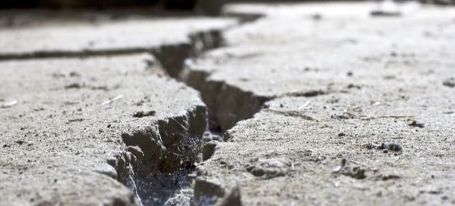

Interior and exterior walls sometime form cracks that need to be filled. The type of wall repair you will have to undertake depends, of course, on the type of wall. Indoors, homeowners may be confronted with plaster wall repair, while outside a concrete wall waits to be fixed. Whatever the type, there are simple and effective ways to patch any cracks that may occur.

Concrete: Same goes for concrete, but since it is outside, more dirt and debris might have accumulated. Before patching, prepare the surface by cleaning it thoroughly with a jet setting on a hose or even a pressure washer if you have one. Go as far as scrubbing the area with a heavy sponge if you have to. You want it very clean!

Concrete: Depending on the type of epoxy you have, work in the first layer with either a brush or a spackling knife. If the crack is deep, it is probably better to use a brush. Don’t slather it on in one thick coat, for it could pull itself away from the wall if you do. Rather, apply several thin coats, giving each one time to adhere to the surface and properly fill in the crack.

Concrete: After the final coat has been applied–not too quickly, so it sets–brush over the repaired spot with a clean, slightly damp brush to get the texture to match the rest of the wall. If wall color is a consideration, let it dry and paint over your work.
