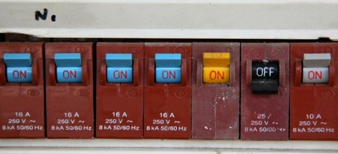

Your electricity is connected to the home at a meter, which measures the home’s usage in watts or kilowatts. In newer homes, there is the main switch inside the meter or just inside the home from the meter, which, if thrown, will shut off the flow of electricity to the inside. In this case, there will also be a subpanel, which can be located almost anywhere in the home. The subpanel is a box that contains a system of circuit breakers, which subdivide and enable the flow of electricity to the individual rooms and appliances in the home.
Each circuit breaker is rated for amperage and each allows a certain flow of electricity to meet the needs of a room or particular appliance. If there is a surge of electricity and the flow of electricity exceeds the circuit breaker’s rating, it will shut off automatically. It is generally easy to tell which breaker has shut off because the switch on the breaker will be thrown in the opposite direction of all the other breakers. It should be noted that safety requires each breaker be labeled to show what room or appliance it controls.
While circuit breakers can go bad and burn out, typically you need to only throw the switch back to the on position to restart the flow of electricity. In much older homes that have not had their electrical systems upgraded, there is likely no main shutoff—the electric panel box is connected directly to the electric meter. It may even contain a system of individual glass fuses, also rated in amperage, which control the flow of electricity to each room and appliance.
Such systems are often underpowered and frequently cannot handle the power requirements of modern appliances, so it is easy to blow a fuse. If that amperage is exceeded the fuse will burn out and require replacement—simply screw out the old one and screw in the new one with the same amperage rating.
