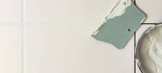

Grouting a white tile floor with grout and a spatula.
The only efficient and quick way to remove grout is by using grout removal tools. There are a number of these on the market, which include some incredibly effective power tools. In many instances, these tools grind the grout away with ease, allowing you to be rid of stained or cracked material. Here are five of the best tools available to you.
