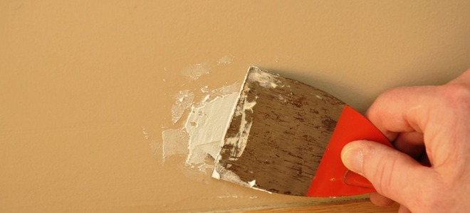

Fixing a Hole in the Wall
Holes in the wall
Maybe you were moving some furniture and accidentally put a chair leg through the wall (or a game of indoor football got a little out of hand). Whatever happened, there is now a hole in the wall and you don’t want to call the landlord to fix it. If the hole is small enough, say about the size of a fist (no judgement), then you can go to a local hardware store and buy a simple patch kit. The kit includes mesh to cover the hole, a small amount of spackle, and a tool for application. Larger holes require custom-cut mesh and more spackle.
If the hole is very large, then it may be best to simply replace the drywall. Cut out the drywall to the studs and place a new panel that fits using drywall screws, spackle, and tape.
Once the hole is fixed, no matter the size, wait for it to dry and sand it smooth. Once it’s completely smooth, prime and paint it, and you’re good to go.
