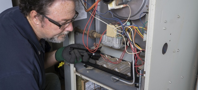

The furnace is one of the most important elements in an HVAC system. But between buying a new unit and having it professionally installed, it doesn’t take long before the costs add up. Luckily, you can save some money by setting the furnace up yourself. Here is a quick guide on how to install a furnace on your own.

Step 8 - Run the Furnace
If the furnace turns on and everything is properly installed, it is time to run the unit through one cycle. While the furnace is running, check the drainage pipes for leaks. You should also compare temperature readings from the outlet air and the temperature rise and make sure they are in line with the specs. Lastly, check again for any gas leaks.
