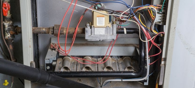

The inside of a furnace.
A properly working furnace is essential when the cold weather arrives. While furnaces are great for keeping houses warm and cozy, they require regular maintenance and upkeep to ensure they work correctly. From a busted blower to thermostat problems, here is a guide on how to troubleshoot the most common furnace issues.
